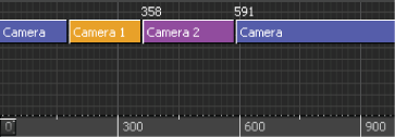

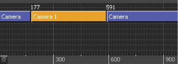

Click Delete Key to delete a camera switch. The Delete Key button removes a selected camera switch in the Switcher timeline and also removes the keyframe from the Transport Controls timeline.
Switcher timeline before the Camera 2 switch is deleted
Switcher timeline after Camera 2 switch is deleted. Camera 1 fills the empty space.

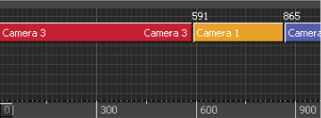

Click Clean-up to remove any redundant camera switches that might reduce system performance.

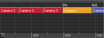

For example, in the following figure, there are three Camera 3 switches. In the figure that follows that, the Clean up button is clicked, and the three switches become one Camera 3 switch that lasts the duration of the previous three.
Three Camera 3 switches in a row

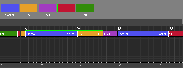

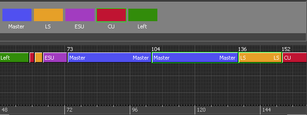

You can move a switch by dragging it to a new position on the Switcher timeline. You can also move multiple switches at once. Ctrl-click the switches you want to move, right-click the Switcher timeline. and then select Link selected clips.
Two camera switches linked
Two camera switches moved to the right

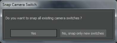

    When you select either of the two snapping methods, a dialog box appears asking if you want to apply snapping to all switches or new switches .
    Snap Camera Switch dialog box
  2. Click “Yes” to snap all current camera switches or click “No, snap only new switches” to ignore the existing camera switches, and snap only new camera switches.
