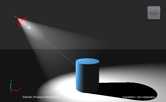

Example: Dynamic Lighting
Sample Viewport Output:
Program Summary: The program below creates a plane (FBModelPlane
), a blue cylinder (FBModel
), and a spotlight (FBLight
) pointing at the cylinder. The Dynamic Lighting
shader is bound to the plane and the cylinder to allow the light to project onto their surfaces. The Live Shadow
shader is bound to the plane to allow the cylinder's shadow to project onto the plane's surface.
