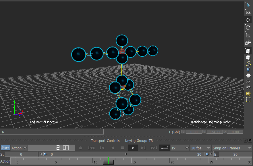

Example: Animating a Character With Poses.
Sample Viewport Output:
Program Summary: The following program builds on the program presented in FBCharacter - Characters. We define two new functions to make the character perform a looping "crouching" animation:
  • createPoses(): This function creates two poses, the first of which is the T-Pose of the character. The second pose has the character's hips effector translated to (0, 50, 0). Character poses are taken via FBCharacterPose.CopyPose().
  • createKeys(): This function keys the character every 15 frames, according to the specified list of poses. Poses are applied to the character via FBCharacterPose.PastePose().

# Main.                                                       #
# Clear the scene.
FBApplication().FileNew()
# Create a new skeleton.
characterName = 'MyStickman'
skeleton = createSkeleton(characterName)
# Apply a model to each limb of the skeleton.
templateModel = createModel()
applyModelToSkeleton(skeleton, templateModel)
templateModel.FBDelete() # We do not need the template model anymore.
# Characterize the skeleton and create a control rig.
character = characterizeSkeleton(characterName, skeleton)
# Create the poses
poseList = createPoses(character)
# Create keys in the player control.
lastFrame = createKeys(character, poseList)
# Play the animation.
lPlayer = FBPlayerControl()
lPlayer.LoopStart = FBTime(0, 0, 0, 0)         # Set the start time in the player control.
lPlayer.LoopStop = FBTime(0, 0, 0, lastFrame)  # Set the end time in the player control.
lPlayer.LoopActive = True                      # Enable playback looping.
lPlayer.GotoStart()                            # Play the animation from the beginning.
lPlayer.Play()
