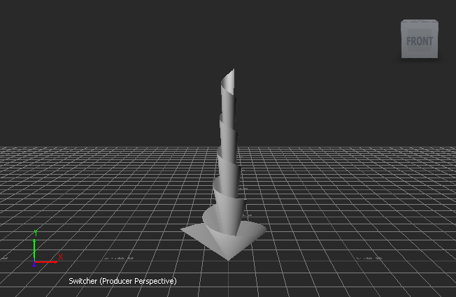

Example: Spiral Mesh
Sample Viewport Output:
Program Summary: The program begins by creating a spiral mesh object. The spiral mesh object is then assigned to the geometry of an FBModelCube (FBModel.Geometry), effectively replacing the cube's mesh with the spiral mesh.

# Main.                                                       #
# Clear the scene.
FBApplication().FileNew()
scene = FBSystem().Scene
# Create a spiral mesh which we will assign to a model.
spiralWidth = 5
spiralHeight = 150
spiralMesh = createSpiralMesh(spiralWidth, spiralHeight)
# Create a model, whose mesh we will replace by the spiral.
model = FBModelCube('myModel')
model.Geometry = spiralMesh
model.Show = True
