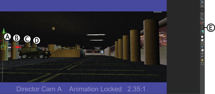

The following figure displays a parking lot scene in the Viewer window. The scene displays a car, which is parked between the pillars B and C. Each pillar in the scene is an object.
Camera view of a parking lot scene in Viewer window A, B, C, D Pillars E. Temporary Pivot Shift icon

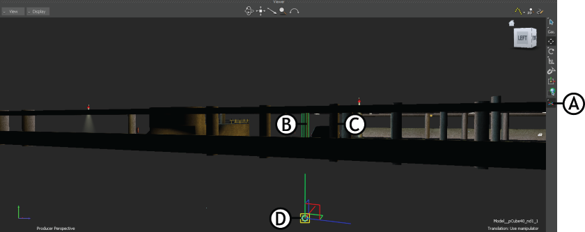

In the following figure, the pivot of the pillar B is offset at some distance from its center. The offset location of the pivot is not visible in the normal camera view. To view the actual offset position, you need to rotate the scene until you locate the pivot.
Parking lot scene rotated to locate the pivot of pillar C A. Pivot Mode B, C Pillars between which the car is parked D. Offset location of the pivot of pillar C

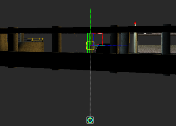

    The pivot moves from the offset position to the center of the bounding box of the object, as shown in the following figure:
Notice that the coordinates of temporary pivot and the line that connects the offset location and the temporary shift to the bounding box center appears dotted. This specifies that the shift from offset pivot location to the center of an object is only temporary.

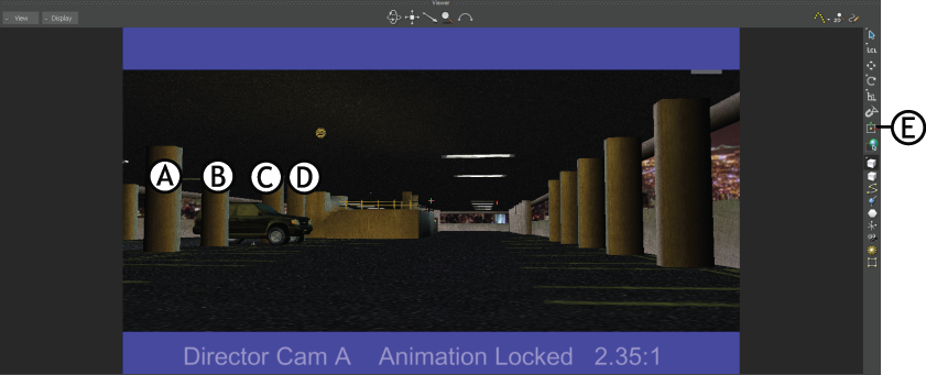

In the temporary pivot mode, selecting any object in the scene shifts the pivot of the respective object, temporarily from its offset location to the center of the bounding box. So you can select each pillar and move to the desired location in the scene.
Parking lot scene A, B, C, D Pillars moved backward E. Temporary Pivot Shift tool active
