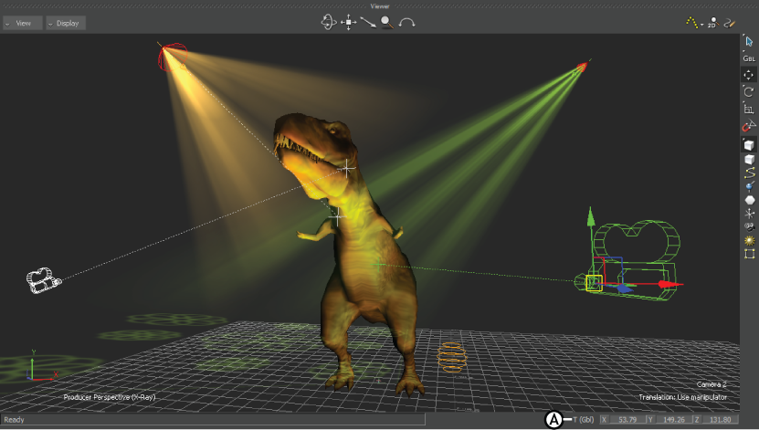

Transform objects using specific coordinates
You can transform objects by typing specific coordinates values into the Global/Local/Layer fields of the Viewer window.
To transform objects using specific coordinates:
Click and drag left or right in the Global/Local/Layer fields of the Viewer window to decrease or increase the value.
Note: To change the value using smaller increments, right-click and drag in the field.
Double-click in the X, Y, or Z fields, type the new value, and click Enter.
The currently selected Transformation and Reference modes are displayed beside the Global/Local/Layer fields in the Viewer window.
Viewer window A. Global/Local/Layer fields
