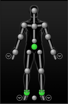

Character representation
Displays an image of a biped character and all the effectors you can use to animate the HIK Control rig.
Once you create a Control rig for your character definition, the Character representation biped displays cells for each IK and FK effector in the rig. These cells provide visual feedback on the pinning, blend, and pull defined for each effector, and also let you create and select auxiliary effectors and pivot effectors.
Before you can use any of the cells in the Character representation, the character must be characterized and active.

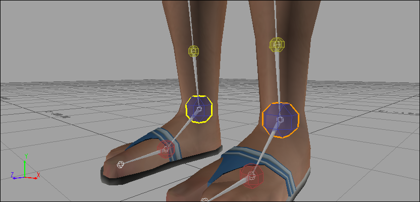

In the Viewer window, a colored outline displays on effectors that have adjusted Blend settings. You can show, hide, or change the visual feedback on Control rigs, including the Blend outlines, using the Properties window.
Colored outlines display around objects with defined Blend values

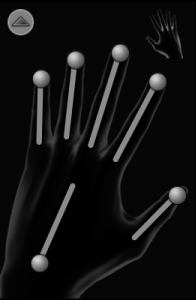

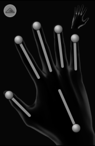

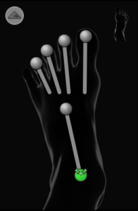

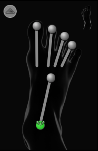

Body Part views
Arrow icons next to the hands and feet in the Character representation let you switch to zoomed in views where you can select individual effectors within the character's hands and feet. Clicking on the hand or foot icon in the upper right corner of each view toggles between the left and right body part.
Hands
Feet
