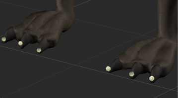

Finger Tips
Contact spheres used to display the finger tips or toes of a character. The finger tips for a quadruped character display in the following image.
Finger tips of a quadruped character
