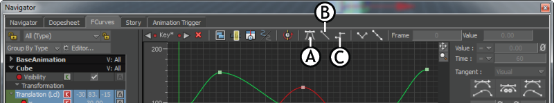

By default, MotionBuilder automatically manages the slope, or interpolation, of function curves. The Auto, Linear, and Step tangent options allow you to manually change the interpolation values between keyframes in order to modify the animation. These three tangent options appear in the FCurves pane normal mode, as shown in the following figure:
Tangent options in the FCurves pane normal mode A. Auto B. Linear C. Step

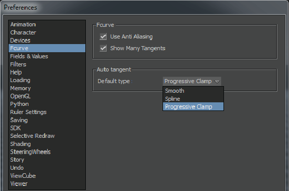

Auto interpolation mode automatically adjusts the tangents of an Auto key type, based upon the interpolation of the previous and next keys. How this tangent will be affected is based upon one of the Auto types, which you can choose from the FCurve Preferences window.
Auto tangent default types in the Preferences window
The following table describes the default types of Auto tangent:
Auto tangent default typeDescription
Progressive ClampThis is the default Auto type. As an all-encompassing Auto key type, Progressive Clamp is a combination of spline, clamp, and flat behavior. Characteristics of this key type:
  • Time independent
  • Clamp with ease-in and ease-out behavior
  • Flat overshooting and undershooting interpolation
SplineCharacteristics of this key type:
  • Time independent
  • Clamp (optional)
SmoothCharacteristics of this key type:
  • Time dependent
  • Clamp (optional)

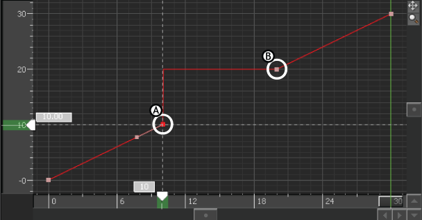

Set Keys to Constant Normal option
When this option is active, Stepped interpolation maintains the value of the selected keyframe until the next keyframe.
Step interpolation A. Selected keyframe B. Next keyframe

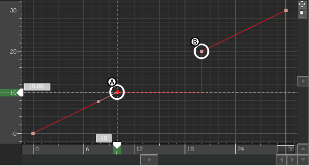

Set Keys to Constant Next option
When this option active, Stepped interpolation maintains the value of the next keyframe between the selected and next keyframes.
Step Next interpolation A. Selected keyframe B. Next keyframe
