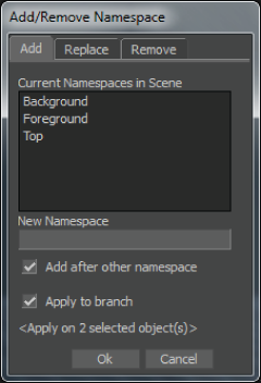

    The Add/Remove Namespace dialog box appears, displaying in numeric alpha order the namespaces in the scene.
    Add/Remove Namespace dialog box displaying namespaces in scene
  3. Click the “Add” tab.
  4. To add a namespace after a prefix, Activate the “Add after other namespace” option.

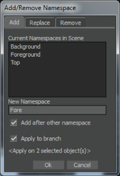

  5. Enter characters in the “New Namespace” field.
    Add/Remove Namespace dialog box displaying namespaces to prepend to branch
  6. Ensure the following options are enabled:
    • Add after other namespace
      When this option is enabled, the name entered in the “New Namespace” field is prepended to the current namespace(s).
    • Apply to branch
      When this option is enabled, the name entered in the “New Namespace” field is prepended to the whole branch.
      Note: To change only the first occurrence of the prefix, leave the Apply to branch option disabled.
    Prepending namespaces to objects or branches may affect the merge-back of the animation as this process is based on the names of objects and branches.
  7. Click OK.
