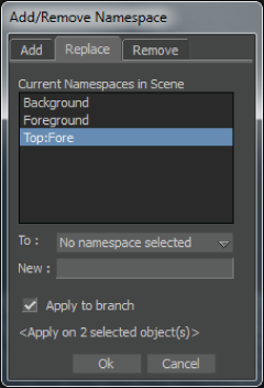

    The Add/Remove Namespace dialog box appears, displaying in numeric alpha order the namespaces in the scene.
  3. Click the “Replace” tab.
    The selected object’s or branch’s namespace is highlighted.
    Selected object’s namespace highlighted in Add/Remove Namespace
  4. Click in the “New” field and enter a prefix.
    Note: You can enter multiple prefixes by separating them with a colon (:). For example, enter Leg:Arm to create a search for both Leg and Arm prefixes.
    Warning: Replacing namespaces for objects or branches may affect the merge-back of the animation as this process is based on the names of objects and branches.
  5. Click OK.
    The namespace for the selected object is replaced with the name specified in the Add/Remove Namespace “New” field.

  2. Enable the “Apply to branch” option.
    Applying a prefix to a branch enables you to search for every instance of the prefix(es) occurring on the selected object(s).
