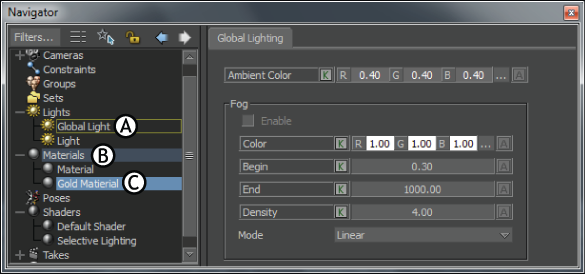

To select assets in a scene, click or double-click them in the Asset list of the Scene browser. When you select assets in the Asset list, three different colors indicate the selection and what displays in the Asset Settings area: The yellow outline indicates the asset’s settings are displayed in the Asset Settings area. The dark blue color identifies the asset’s branch. The light blue color identifies the selected asset.
Asset list selection colors A. Yellow outline B. Dark blue C. Light blue

ColorIndicates
Light BlueThe currently selected asset or folder. This is not necessarily the same asset appearing in the Navigator window. You can have more than one selected asset.
Dark BlueAt least one asset is selected within its folder or hierarchy.
Yellow OutlineThe asset displays in the Asset Settings area of the Navigator window. Only one asset can display in each Navigator window.
