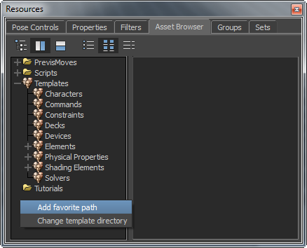

You can add and remove from the Asset browser pane a path to a folder located on your computer or network. Adding favorite paths in the Asset browser pane enables you to quickly access folders without the need to remember their locations.
To add a favorite path:
  1. In the Asset browser pane, right-click and select Add favorite path from the context menu.
  2. In the Open directory dialog box that appears, navigate to the desired directory, select the folder you want to add, and click OK.
    The selected folder displays at the top bottom of the browser pane.
To remove a favorite path:
  • In the Asset browser pane, right-click the folder you added and select Remove favorite path from the context menu.
