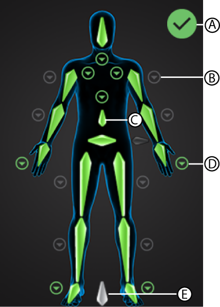

The main Character view lays out the HumanIK nodes in a schematic arrangement that indicates the placement of each bone in a biped. It provides a visual tool for mapping out the structure of your character, and provides feedback on the status of the skeleton definition.
Character view A. Validation status B. To Leaf Roll bones C. Required bones D. To other views E. Reference

Validation status
Displays the validation status indicator at the top-right of the Character view.

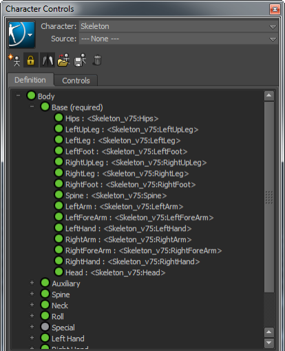

Name Match view
Displays all bones in a list, grouped according to their related body part or IK effector. Use this view to get an overview of your skeleton definition, and to view the names of the bones assigned to multiple different nodes. You can map bones to the Name Match view using the same methods as in the Character view.
