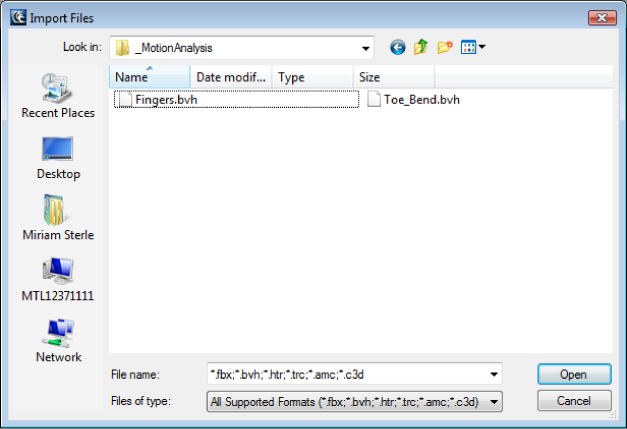

To import files, select File > Motion File Import from the MotionBuilder menu bar. The Import Files dialog box displays letting you choose one or more files for import.
Import Files dialog
To select more than one file, select the file type, click the first file and Ctrl-click each file that you want to add to your selection.
