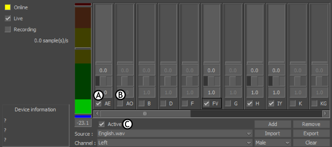

Activating and disabling sound parameters
When you add a sound parameter to the Voice device, it is active by default.
To disable a parameter:
- Disable the sound parameter’s Active option.
To disable all paramaters:
Disable the main Active option in the Voice device settings.
Voice device settings A. Sound parameter activated B. Sound parameter disabled C. Active option
Note:When a sound parameter is disabled, you cannot change its settings.
