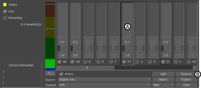

Select the sound parameter you want to remove.
In the following figure, the FV sound parameter is selected (see A).
Click Remove (see B).
Voice device settings
To clear all sound parameters:
In the Voice device settings, click Clear.
In the Voice dialog box that appears, click Yes to confirm you want to clear all the sound parameters.
