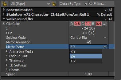

Select the Story animation clip.
In the Properties tab of the Resources window, select and expand the animation.
Turn on Mirror Animation.
From the Mirror Plane list, choose an axis option. For example, to mirror animation along the global Z-Y plane, select Z-Y.
