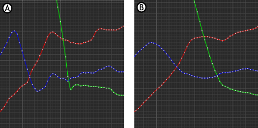

Like the Smooth filter, Smooth Translation averages all keyframes to smooth movement. Smooth Translation also smoothes the curve motion by reducing the shaking of data.
Shaking (or “noise”) mostly occurs on translation data obtained with motion capture devices. Smooth Translation was specifically developed for smoothing translation curves.
Smooth Translation A. Original curves B. Smooth Translation applied
