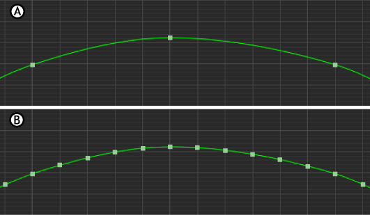

Resample A. Original curve B. Resample applied
