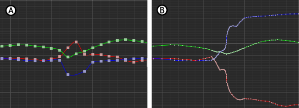

Visually compensates gimbal locking effects by adding additional keyframes to rotation function curves.
These additional keyframes compensate for sudden flipping or shaking caused by the interpolation between keyframes during large rotational changes. Gimbal lock is most often encountered when you plot animation onto the skeleton (bones) of your model.
Gimbal Killer A. Original curves B. Gimbal Killer applied
