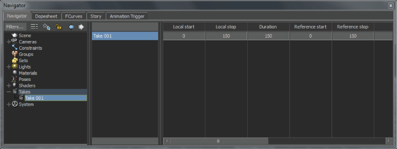

Takes settings
The Takes settings show information about your takes, let you delete and rename them, as well as change their length and the order in which they are listed.
Select the Takes root folder in the Scene browser to display the Takes settings in the Navigator window.
Takes settings
| Option | Description |
| Take list | All of the takes in your scene are listed in the Takes list. There is one row for each take in your scene. |
| Local start | Lets you change the start time of the take in local timecode. |
| Local stop | Lets you change the stop time of the take in local timecode. |
| Duration | Displays the duration of each take. |
| Reference start | Lets you change the start time of each take in reference timecode. |
| Reference stop | Lets you change the stop time of each take in reference timecode. |
| Comments | Lets you write and save comments such as director’s notes for each take. To insert a comment, click the cell and type your comment. |
