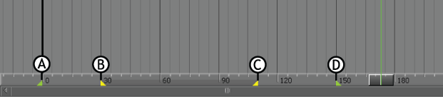

In the Story window, drag the green markers at the bottom of the Action Track list. The green markers indicate the start and end of the take (A and D) and correspond with the Start and End fields in the Transport Controls window.
Time range A. Start of take B. Start of zoom bar C. End of zoom bar D. End of take
