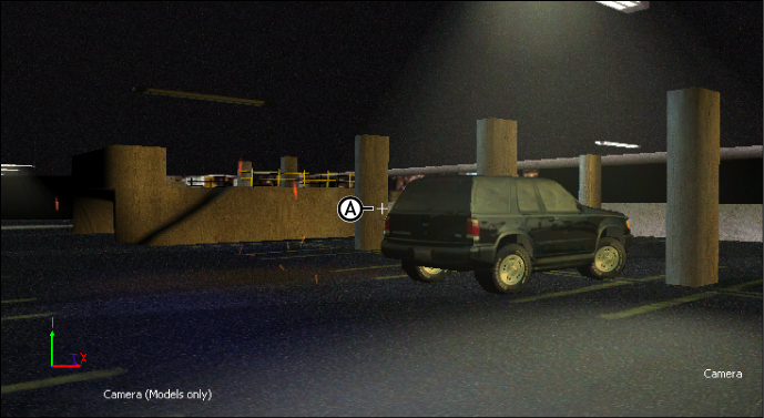

Showing the camera center point
The camera center point option lets you show or hide the center cross hair that marks the central point in the camera view.
A. Camera center point
To show the camera’s center point:
- Right-click a camera in the Scene browser or Viewer window and select make Current from the context menu.
- In the Navigator window, activate the Center option in the Camera Settings View area.
