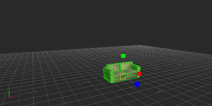

Scaling an object changes its size. You can uniformly expand or shrink an object on all axes to uniformly change its size, or you can scale an object on only one axis to deform it.
Selected object in the Viewer window displays with Scaling handles for scaling the object on each axis
For example, in the preceding figure, the sofa has Scaling handles that you can drag with your mouse to scale the object.
In order to scale objects, you must put the Viewer window in scaling mode.
Scaling mode
When you are in Scaling mode, Scaling handles appear on any selected object. Each Scaling handle is color-coded to its specific axis. The red handle scales along the X-axis, the blue handle scales along the Z-axis, and the green handle scales along the Y-axis.
Scaling handles on the selected object
