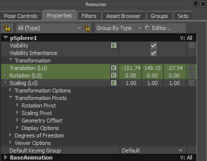

The Transformation Pivot group of properties lets you manipulate pivots for rotation and scaling. Each pivot can be positioned independently relative to the object’s geometry. See Creating pivot offsets.
Property Resources: Transformation Pivot properties

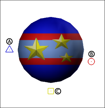

In the Viewer window, pivots are represented by two-dimensional icons that always face the camera and always appear to be the same size regardless of the position or zoom of the camera. Translation pivots are represented by a blue triangle icon, rotation pivots by a red circle icon, and scaling pivots as a yellow square icon.
The Transformation pivots are not displayed by default. However, their visibility is enabled when you offset them or when you enable their visibility.
The Transformation pivots in the following figure are offset.
A ball's Transformation pivots A. Translation pivot B. Rotation pivot C. Scaling pivot
