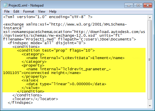

  8. Click Export and save the xml file locally.
  9. Right-click the xml file > Open with Notepad or similar text editor.
    The xml file will look something like this:
  10. In your xml file, copy the lines of code that correspond to the condition node highlighted in yellow above.
