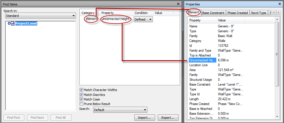

A key part of this process is locating items with specific model properties in the Find Items window, exporting those properties into an XML file, and modifying them to map to your chosen takeoff property. It may be helpful to view the Find Items and Properties windows side by side:

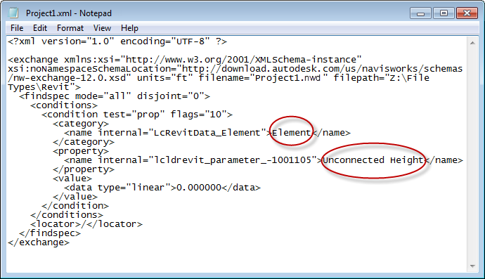

In the image above, notice how the Element category in the Find Items window (left) is shown as the Element tab in the Properties window (right), and Unconnected Height is displayed in the Property column in each window. You can then Export in the Find Items window to produce an XML file as shown below. Notice how Element and Unconnected Height are coded:
You can then customize these and other properties in different nodes or code sections of the file, to map to a specific takeoff property. In this case, you could map Unconnected Height to the takeoff property, Height. You then either copy them into your master map (TakeoffPropertyMap.xml) or into a new map. Once saved and Quantification is reopened, your new property values are visible. We have created three topics that show three different customization scenarios:
