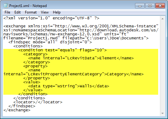

    The xml file will look something like this:
  11. In your xml file, copy the lines of code that correspond to the condition node highlighted in yellow above.
