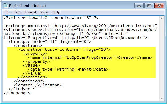

  10. Right-click the xml file > Open with Notepad or similar text editor.
    The xml file will look something like this:
  11. In your xml file, copy the lines of code that correspond to the condition node highlighted in yellow above.
  12. Open the property map file here: C:\Program Files\Autodesk\Navisworks Manage [year]\Quantification\takeoff_maps\TakeoffPropertyMap.xml (or use a file map template of your choice). Paste your copied text into the property map file (find and replace the existing condition node if it is visible in the file).
