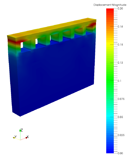

Results can be imported and viewed in the Simulation Utility for Netfabb or in ParaView. Figure 2 shows the computed final distortion after substrate release.
Figure 2: Final distortion

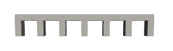

Producing distorted and compensated STL files from the simulation results
After the thermo-mechanical simulation is completed, the mechanical results can be used to output warped and compensated STL files. Warped STLs can be used for post-process analysis, to ensure assembly fit or other dimensional checks. To produce a warped STL, use the included program distort_stl.
$ distort_stl warp.txt
By default the program uses the distortion results after cool down but before removing the part from the build plate. The resulting distorted STL, 02_mechanical warp.STL, is shown in Figure 3.
Figure 3: Warped STL
A compensated STL takes the prediction distortion results, inverts them, and applies them to the original geometry. This produces a geometry which should distort into the desired shape. To produce the compensated geometry, use the distort_stl program again:
$ distort_stl comp.txt
The resulting compensated STL, 02_mechanical_compensated.STL, is shown in Figure 4.
