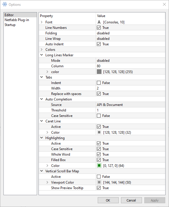

Editor options
Font General font settings to be used for all text editor windows
Line numbers Optional line numbers left of each line in a text editor window
Folding Optional folding control to hide/show individual scopes of script code. Several kinds of control styles are available.
Line wrap Optional line wrap mode. Lines can be wrapped between words or at any character.
Auto indent Optional automatic line indentation based on code structure
Colors A variety of colors can be configured here for the editor window and code syntax highlighting.
Long line markers For a given line length limit a marker can be visualized to assist the user with observing line length.
Tabs Options on how the tab key and tab character shall be handled
Auto completion Auto completion can suggest text when the user starts to type. The suggestions can be based on the API or the content of the current document.
Caret line Highlighting the line where the cursor is actually in
Highlighting Highlighting of all occurrences of selected text
Vertical scroll bar map A vertical scroll bar showing a simplified view of the whole document content

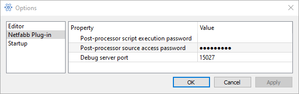

Plugin options
Post-processor script execution password A password to protect an exported EBPA from being executed in a target application without authorization
Post-processor source access password A password to protect an exported EBPA from being reopened in ATU without authorization, protecting the source code
Debug server port Network communication port used by ATU to interact with script execution while debugging.

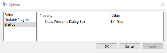

Editor options
Show welcome dialog box On application start a dialog opens to offer quick access to recently used projects
