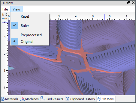

3D View
The 3D view simulates the printing result by slicing imported parts and stacking up each layer. The currently selected layer in the Exposure Preview window is highlighted in red.
In the View menu, the current view position and angle can be reset to default values and the ruler can be hidden. It is also possible to switch between a preprocessed view and the original model representation (the imported file). When changing to the preprocessed mode, potential model changes scripted at the preprocessLayerStack JavaScript function are made visible, and it is possible to compare both versions.
