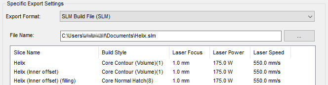

When exporting to certain formats (buildfiles for SLM, LSR, NSP, AI, or ILT), a section in the export dialog is available to adjust these. The export loads built-in defaults that you can modify here for this instance of exporting, and are not saved when you close the dialog.
Example: Slice properties set for export to SLM buildfile. (The parameter named Build Style here is format-specific and only available in this export dialog.)

  5. In Specific export settings, double-click the slice to modify.
  6. In the <format> Export settings dialog, adjust the properties as required by your build.
