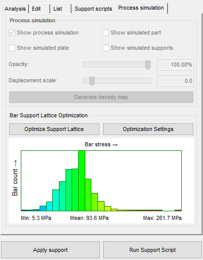

Simulate the lattice
  1. In the context view, switch to the Process simulation tab.
  2. Optional: Click Optimization Settings and adjust simulation parameters as necessary.
  3. Click Optimize Support Lattice.
While the optimization runs, the individual bars in the support are updated, even removed, directly and without further input.
The context view provides a histogram of bar thicknesses.
