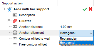

- Choose a support action from the drop-down menu at the bottom and click
OK to add it to the actions listing.
Tip: Both the current cluster detection values on the Analysis tab and any values present in the currently selected set of defaults on the Edit tab are used as much as possible to initialize the action's value on adding it to the script listing.
- Modify the settings for selected support actions as needed.
Modifying a support action
