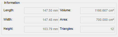

  1. To determine the size of the center space, a good start can be to assume a multiple of the outbox size of a part that is to be packed in the center space. To quickly check an outbox size, select a part and check the context view.
    Example: The selected part is roughly 15 by 15 by 11 cm in size.
    Take the values of any two sides. Depending on the size you decide to give the center space later, the part may end up rotated.
