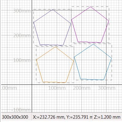

  • 2D view
    Graphical representation of the slices, and also provides access to context menus.
    The 2D view shows labeled axes, bounding boxes as dashed lines, an auto-scaling grid, and the corresponding platform's outline in addition to the various slice contours. The status bar at the bottom of the 2D view lists the platform dimensions as well as the current mouse pointer coordinates and the z-height of the slice layer currently on display.

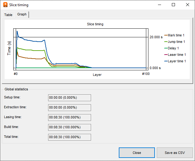

    In the project tree, right-click the respective Slices section itself to access detailed slice time statistics in table and chart representation across the slices and to manage the default properties and their values for new slice stacks.
    Use the slice timing analysis to identify phases of high and low utilization. Hover the mouse pointer over items to highlight the associated curve, and click on items to toggle their visibility.
