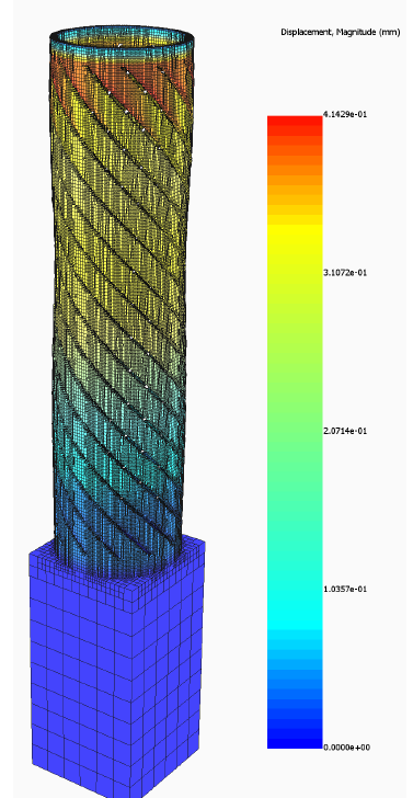

This example requires 4 simulations to produce a PRM file that matches the measurement, including simulating using the base Inconel625 generic.prm.
Search or scroll through the calibration.out file for the calibration block, which starts with ”Probing location.” There are 4 blocks. The ”FEA disp.” line indicates the measured location displacement. These are:
Nominal PRM = -0.48
Calibration 1 = -0.27
Calibration 2 = -0.349
Calibration 3 = -0.31
This gets within the relative error of the measured distortion. The final calibrated PRM file is Inconel625_generic_calibrated.prm which can be used for future simulations for this material and processing parameters.
