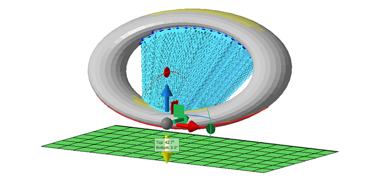

Let Netfabb regenerate existing support entities so that they hit detected or manually specified up-facing part surfaces
With upskin projection, the deflection of already generated support entities is automatically calculated, saving time otherwise spent with manual adjustment. This complements the generation of supports, where bars have some projection functionality and volumes and polylines have none at all.
Creating part-to-part support by regenerating them on a specified target upskin (left)
Projecting volume supports estimates appropriate values for Stand angle and the knee function from position and size of upskins
Using upskin definition
Retargeting with upskin definition works by manually specifying surface triangles. These may be sacrificial bottom plates or other kinds of pedestals merged with the original part

- Select the supports to redirect.
- Right-click them and choose
Upskin projection from their context menu.
- Use the new options in the context view:
- Auto-detect or manually draw upskin areas as a target.
Note: After automatic detection, you must select (dark yellow) one in the 3D view (light yellow) as the target or targets before you can reproject.
- Choose To upskin as a projection method.
- Click Project.
