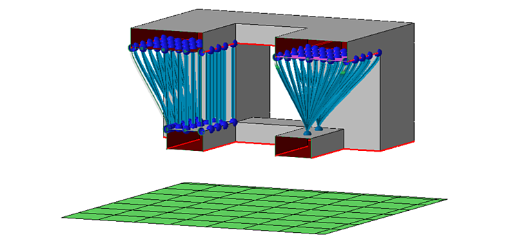

Specify points where bar supports should attach at their lower end
Creating part-to-part support by running an action set up to target specified anchors (right)
Using target anchors
Targeting specific anchors requires two things.
- The anchors
- A script containing the action Bars on areas that has Project bar set to To selected anchor.
To have all eligible bars targeted
- Use the commands from the main menu to place and select anchors on the part surface.
- In the context view, select the Scripts tab.
- From the dropdown menu, select the script with the action you set up earlier. Double-click the
Apply icon to run the action.
