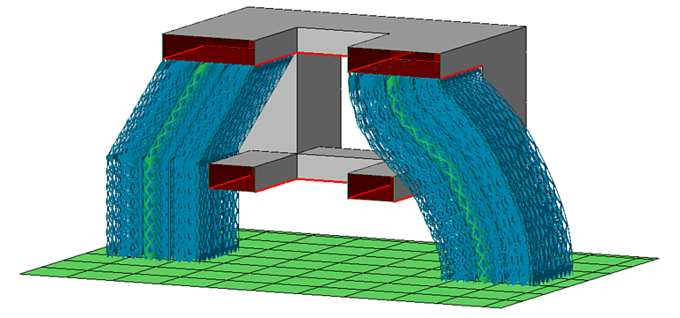

Avoiding part-to-part support with a knee (left) or a spline (right)

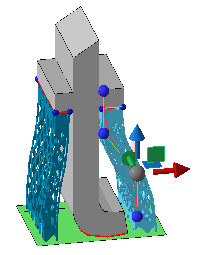

This draws the spline along the support, starting with four control anchors, or "basepoints".
Spline controls
- The top basepoints is always fixed to maintain the attachment location on the part surface.
- The bottom basepoints always moves across the platform surface.
- With the basepoints second from top or bottom, you control the last bend each before the actual connection.
- To move a basepoint, click on it and use the gizmo controls.
- To add a basepoint, hover the mouse pointer towards the centerpoint between two existing basepoints and click the transparent basepoint that is auto-generated as you approach the centerpoint.
- To delete a basepoint, right-click Delete basepoint from its context menu, if available.
- The four initial basepoints are fixed and cannot be deleted.
- Visibility of basepoints, the green basepoint line, and the red spline is toggled in its context menu.
