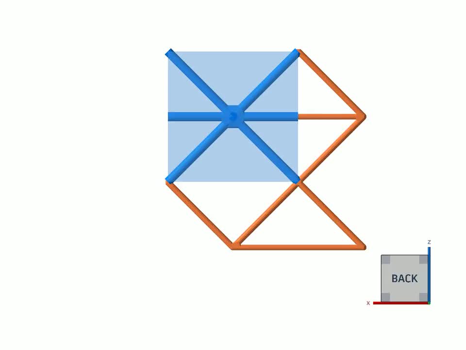

The E unit cell topology is similar to Grid, except that the 2 vertical bars are omitted and instead it has 4 additional bars, one each from the volume center along the XZ plane to the edge centers. Offset, this forms structures resembling "stacks of folding chairs".

  • Solid blue: Topology
  • Solid orange: Neighboring bars
  • Transparent blue: Unit cell
