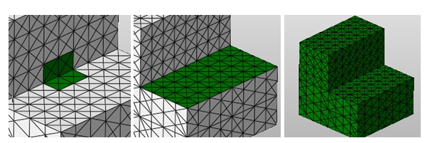

To use the basic selection commands
- Click one of the basic selection commands from the toolbar. Available options include:
Select Triangles: Selects individual triangles.
Select Surfaces: Selects consecutive triangles until they are angled further than a configurable threshold away from the previous one.
Brush Selection: Selects individual triangles by painting over them with a brush.
Select Shells: Selects entire shells.
Tip: Hold Ctrl and click on a triangle, surface, or shell to add to or subtract from the selection based on the current selection state of the clicked triangle.
Left: Selected triangles. Center: A selected surface. Right: A selected shell.

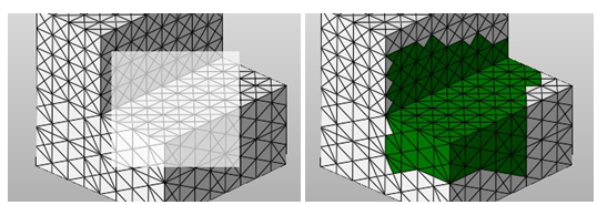

To use the selection primitive
- Click one of the selection options from the toolbar listed under
Selection Primitive. Available options include:
- Select All Triangles: Selects all triangles that lie within the selection primitive, regardless whether they are on the backside of the part or whether they are covered by other triangles.
- Select Front-Facing Triangles Only: Selects triangles facing the front of the display, even when they are covered by other triangles.
- Select Uncovered Triangles Only: Selects triangles which face either the front or back towards the camera, but are not covered by other triangles.
- Select Front-Facing and Uncovered Triangles Only: Selects only the triangles partly or fully visible from the current viewing perspective.
- Choose a selection type. Available options are Triangles or Shells.
- Choose a primitive selection shape. Available options are Rectangle or Circle.
- In the display, click and drag with the mouse to create the primitive shape.
Left: Drag a primitive shape. Right: The resulting selection.

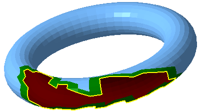

To select triangles around a hole
If you have a part that contains a hole, some actions benefit from, or even require, selecting one or more of the triangles directly touching the hole.
- Right-click an edge of the hole.
- Choose
Select all Surrounding Triangles to select every triangle touching the hole.
- Choose
Select Attached Triangle only to select the triangle adjacent to the edge.
In preparation for freeform-hole closing, the triangles surrounding the hole have been selected.
