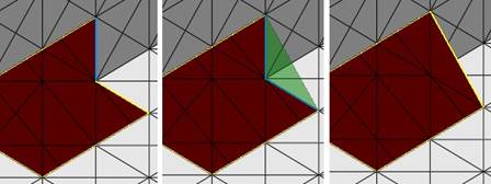

To add triangles
Add triangles to manually close holes or connect edges.
- From the main menu, click
Add Triangles.
- Click an edge surrounding a hole. The selected edge is highlighted in blue.
- Hover your mouse over the other edges around the hole to preview the shape of the added triangle. The triangle preview is shown in green.
- Click an edge around the hole to add the triangle.
Left: First edge highlighted in blue. Middle: Preview of new triangle. Right: Resulting triangle.

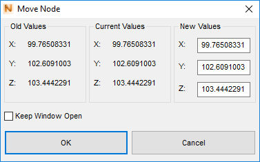

To move a node
Moving nodes allows you to quickly adjust the shape and curvature of the part.
Move Node.
- Click and drag a node in the part to its new position.
When clicked, a label with the X, Y, and Z coordinates of the node appears.
- Release the mouse to finish the move operation.
The coordinate label updates dynamically as you reposition the node.
- Right-click the coordinates label to open the
Move Node dialog:
- Enter X, Y, and Z coordinates.
- Click OK to move the node to the coordinate location specified.
