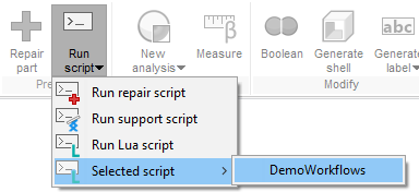

  • If running Lua scripts happens often during working with Netfabb, set any script in the library to appear in a dropdown menu in the toolbar.
    The icon in the toolbar makes Lua scripts readily available.

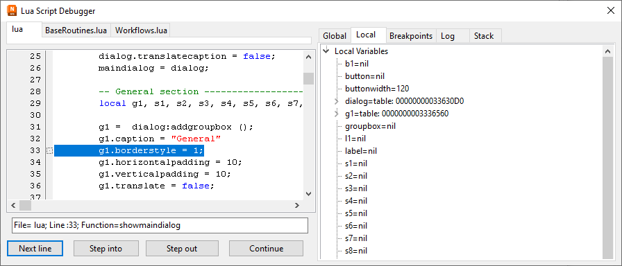

  • The library provides a Debugger to have a closer look at the operation of a script. You can run one line at a time, observe variables, set breakpoints to halt execution at specified steps, and observe output written for logging purposes.
    Stepping through a script can help with identifying mistakes
