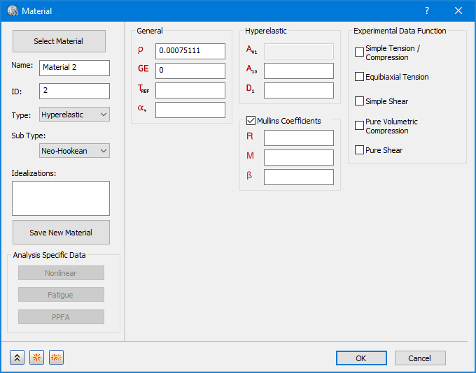

- The generalized Mooney-Rivlin strain energy may be expressed as follows:
where
and
are the first and second distortional strain invariants, respectively;
J = det F is the determinate of the deformation gradient; and 2D1 = K and 2(A10 + A01) = G at small strains, in which K is the bulk modulus. The model reduces to a Mooney-Rivlin material if NA = 1 and to a Neo-Hookean material if NA = 1 and A01 = 0.0. For Neo-Hookean or Mooney-Rivlin materials no continuation entry is required.

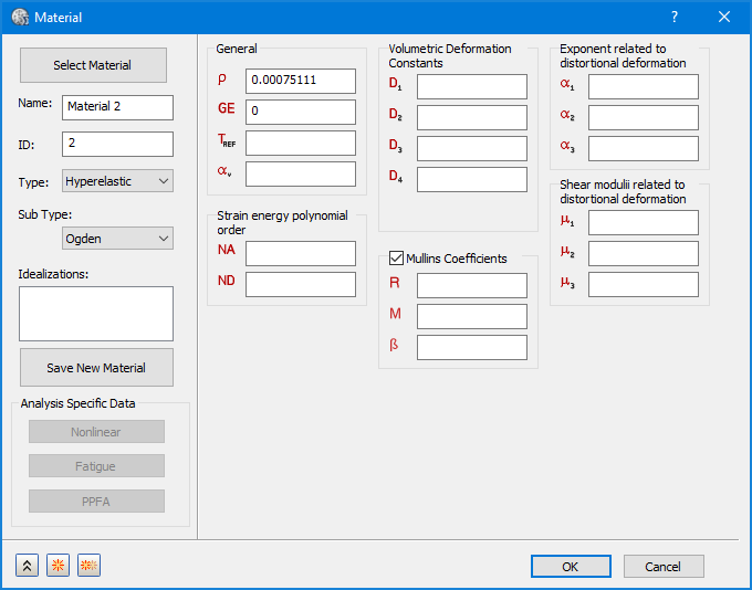

- The generalized Ogden strain energy may be expressed as follows:
where
and
are principal stretches;
J = det F is the determinate of the deformation gradient; and 2D1 = K at small strains, where K is the bulk modulus.
is the current temperature and
is the initial temperature.
The default for D1 is
. The default for D2 through D4 is zero.

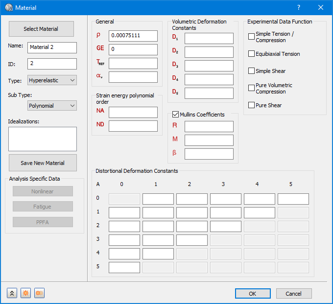

After selecting Hyperelastic from the Type drop-down, the following material sections will become available: Hyperelastic, Experimental Data Function, and Mullins Coefficients.
Hyperelastic
- For Sub Type you can choose from Neo-Hookean, Mooney-Rivlin, Ogden, Yeoh, and Polynomial, as shown in the above images. Each type has a specific set of material constants to define.
- The mass density, RHO, will be used to automatically compute mass for all structural elements.
- To obtain the damping coefficient GE, multiply the critical damping ratio C/C0 by 2.0. If a dominate frequency is not defined for Material Structural Damping (see Dampings section), GE is ignored in transient response analyses.
- TREF is used only as the reference temperature for the calculation of thermal loads in linear solutions. If an initial temperature load is specified, TREF will be ignored.
- You can define the thermal expansion coefficient, mass density, material damping coefficient, and material reference material.
