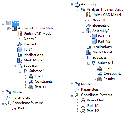

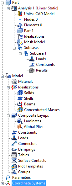

Autodesk Nastran Model Tree
The Autodesk Nastran Model Tree gives a convenient outline view of the various finite element model entities created.
The top level tree items are as follows:
By default the Model level tree items and Coordinate Systems will be in collapse mode.
The following pages describe each of the tree items and its contents.
