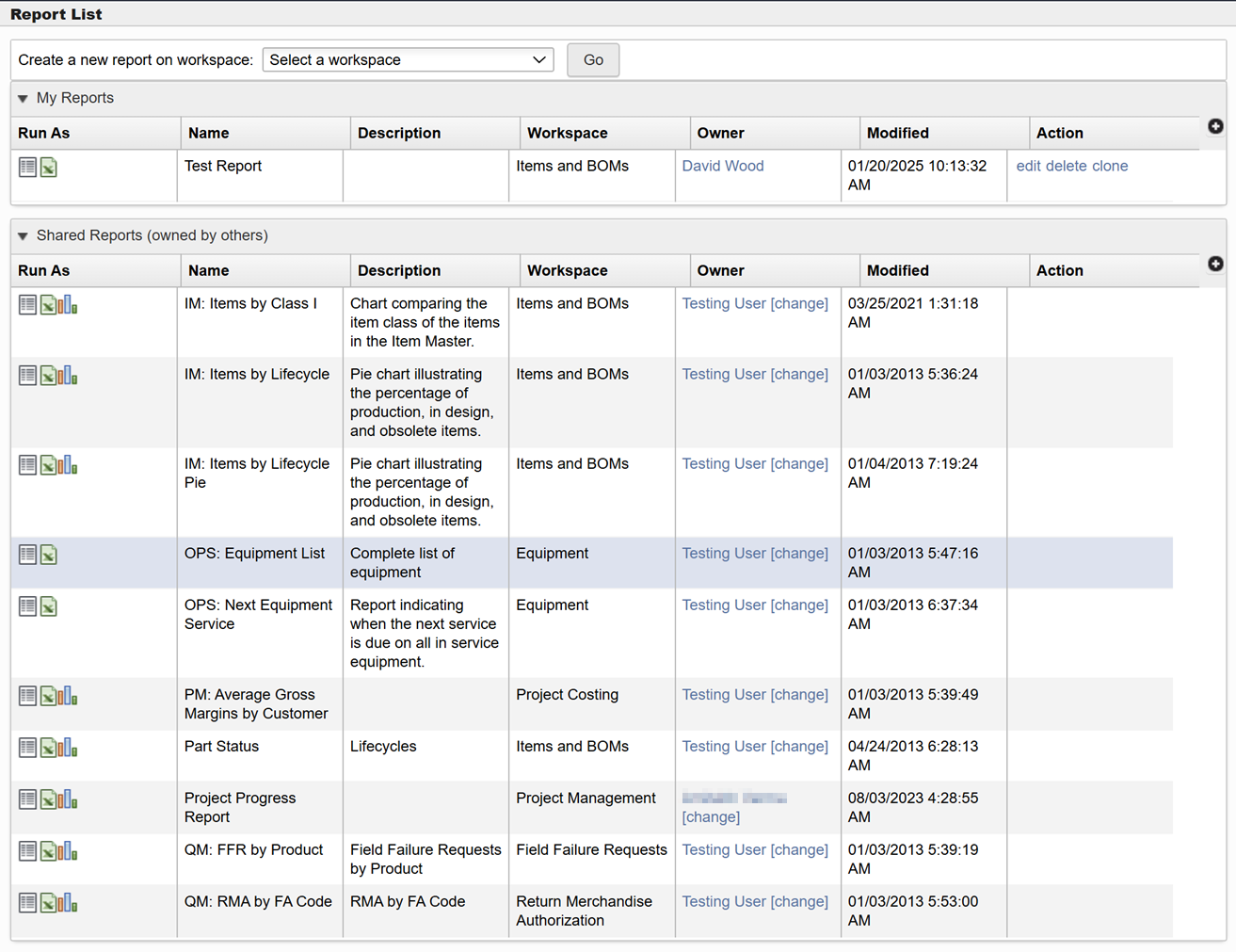

Run reports from the Report List. Reports are specific to a workspace.
Go to Advanced Tools > Reports.
In the Run As column, select whether to generate an HTML file, Microsoft Excel file, or chart:
(The Chart option is only available if a chart has been set up for the report.)
Some reports are created with filters that are editable at runtime. When you run a report with runtime filters, a dialog box appears prompting you for runtime values. Enter the values.
Note: If a default value was specified at the time the report was created, the dialog box is populated with that value. To run the report with a different value, over-write the default value.Click Run.
Tip: If you have permission to run a report as a chart, you can add the chart to the Reports panel of your Fusion Manage dashboard.
