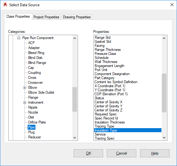

- In the Select Data Source dialog box, on the Class Properties tab, do the following:
- Under Categories, expand the tree to find the item you want.
- Under Properties, click a property (for example: InsulationType). Click OK.
